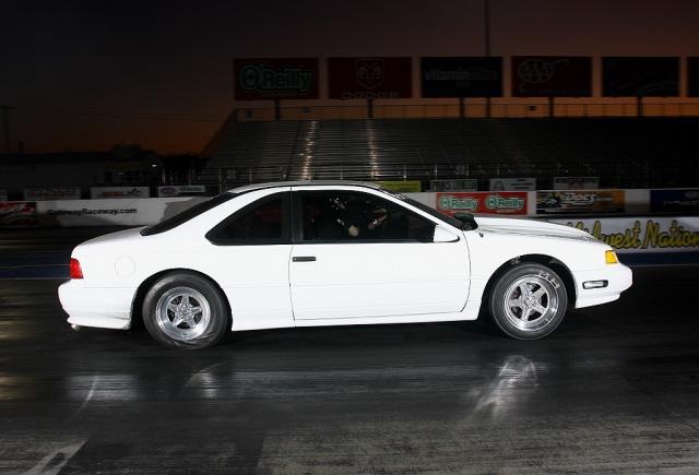

root Опубликовано 30 Июня 2012 Жалоба Опубликовано 30 Июня 2012 Рецепт без иллюзий:SCU 4.2 longblock includes, large valve CNC ported heads, Yella Terra mini shaft rockers, APR studs, MLS gaskets, late model SC block, 4.2 cast crank, Scat rods, Wisco forged pistons, Total seal rings, late model timing cover, custom cam from new core, BHJ dampener, windage tray, ported intake manifold and a Melling high volume oil pump. Kooks longtube headers w/jet hot ceramic coating Custom stainless exhaust by Hyperformance.com March polished aluminum underdrives ESM ported and diffused intake manifold adaptor modded for AR 60# injectors Polished aluminum billet fuel rails Remote mounted Aeromotive adjustable regulator 255 lph FI fuel pump Late model fuel tank 6AN fuel supply line w/oversized filter Magnum Powers 85mm TB Magnum Powers 3.5" intake tube Pro-M 87mm MAF S&B 7" power stack filter Magnum Powers cool air divider SCP solid motor mounts Custom PVC valve oil trap filter Taylor spiral core wires Auto meter dual gauge pillar pod Auto meter full sweep fuel pressure gauge Auto meter electric trans temp gauge Under the hood mechanical oil pressure gauge Billet Flow tensioner pulleys ESM 10% overdrive jackshaft pulley SCU (Dave Dalke) 1.7 AR kit w/ 3.00" 8 rib pulley Magnum Powers polished 3/4" raised top SCT chip tuned by Dave Dalke 180 t-stat Magnum Powers Front mount IC w/ optional 14" pusher fan Griffin aluminum radiator Spal Extreme duty 16" 3000 cfm puller fan Magnum Powers chin spoiler Snow methanol injection system KB Boost-a-Pump AC delete reverse tensioner modDrivetrain Modifications: 3.73 gears Lentech street terminator VB w/ OD delete Lentech hardened 3-4 shaft AOD performance rebuild (extra clutches and Kevlar OD band) Dual B&M 24K GVW stack plate tranny coolers w/800 CFM fan Lentech 9.5 non-locking 2700 stall converter Lentech cast aluminum transmission pan Aluminum driveshaftSuspension Modifications: Boyd Coddington Smoothie II polished aluminum wheels 18"x 8" front/18"x 10" rear Cooper ZEON 2XS 245-45-ZR18 front Cooper ZEON 2XS 275-40-ZR18 rear H&R lowering springs Air Lift air bags, both sides Rolled rear fender lips Solid Transmission Mount 16" Et streets and 17" M&H front runners on custom Bogarts (track use only)Cosmetic Modifications: SS rear bumper lettering inserts Window tint 35% sides and back Magnum Powers chrome dress up panel for hood latch Polished aluminum oil fill cap Cobra R fiberglass hood Chrome hood prop and pins Optima red top w/billet hold down Repainted 2007Audio Modifications: Alpine head unit w/CDBest Time: 10.680 at 129.800 MPHDyno Numbers: horsepower: 374.2 at 6000 RPMtorque: 461.1 at 3400 RPMFuture Plans: Bigger supercharger New Leather Interior Cobra brakesSCCoA Member#: 858Other Club Affiliations: (former)Thunderbird SC Enthusist Community-Secretary TBU (hardcore 5 member)© sccoa.com====================Кто желает посчитать бюджет? Цитата
