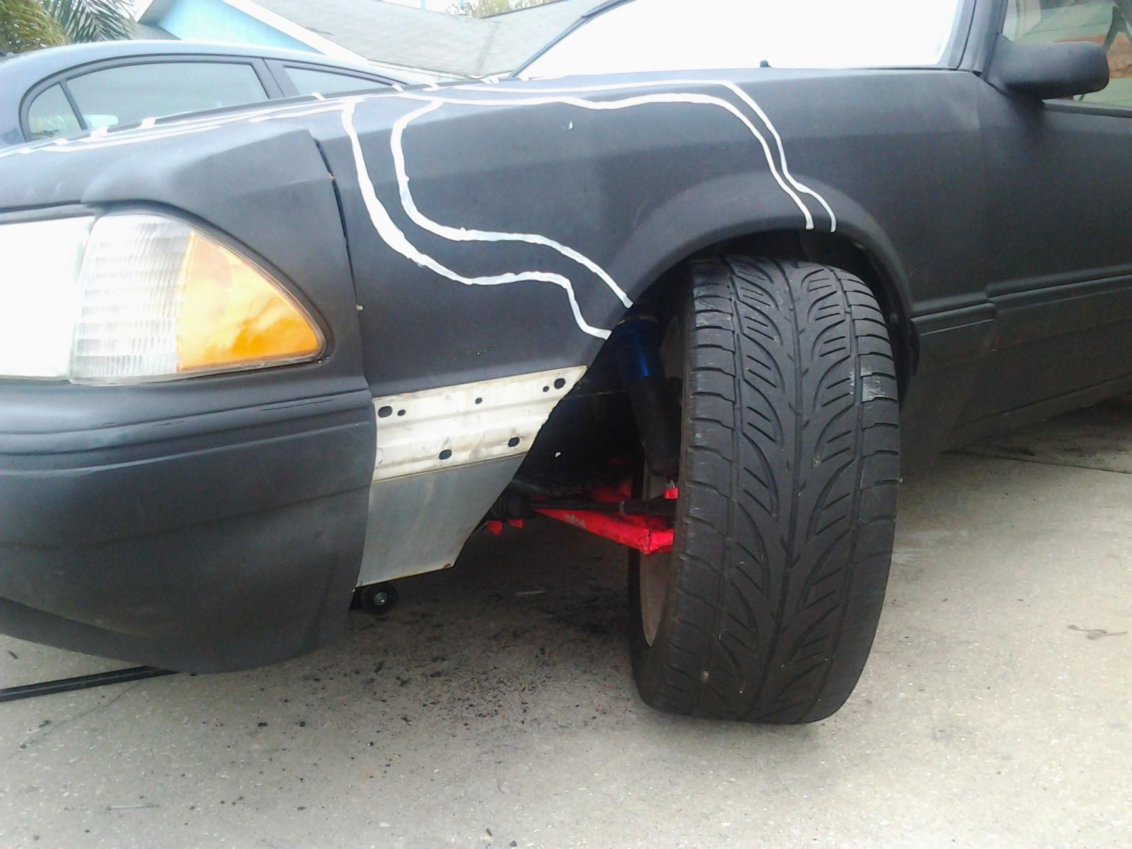

http://talkdrift.com/showthread.php?1756-Custom-tubular-control-arms-on-the-cheap!!!-The-diy-secret-of-steering-angle
post-1814-0-10577500-1410374700_thumb.jp
